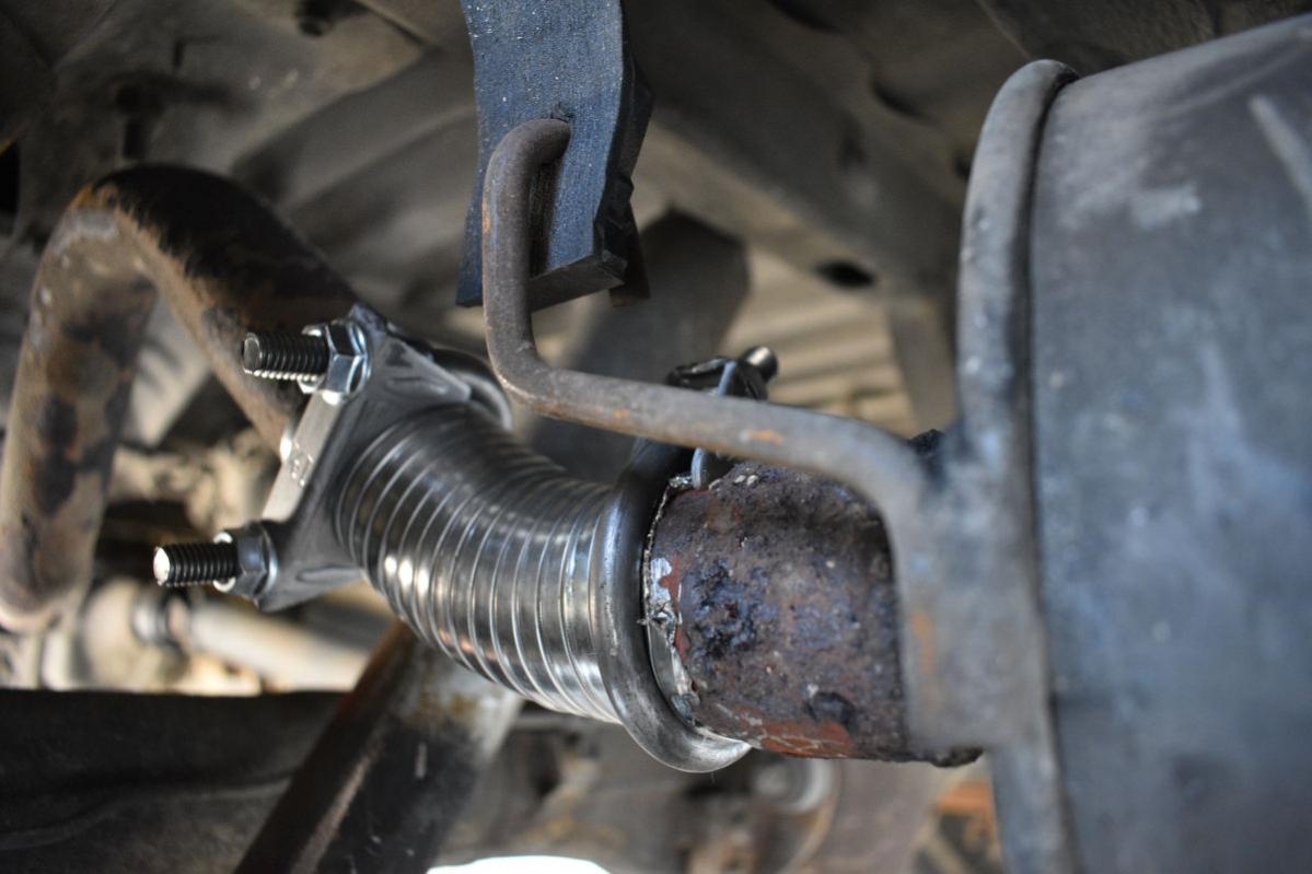

    My muffler fell off after it rusted out, for now I've decided to repair and use it.
    I used a "flexible exhaust repair kit" size 1 3/4" made by Nickson at O'Reilly Auto Parts, it was $8. It only comes with one ubolt, so you need to buy another 1 3/4" ubolt, which is around $3
    https://www.oreillyauto.com/detail/c...it/nic0/540275
    I needed to have a curve to the repair, so I used this flexible pipe, otherwise I would have just used a straight "exhaust connector" with ubolts.
    I cut off the excess rusted areas on both parts of the muffler with a sawzall and then used and angle grinder and grinder wheel to smooth it out.
    This is air tight and will last until the muffler rusts more past the ubolts. Good cheap fix for a about a year or so, or if you need something to pass emission tests
