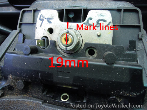

    Mark a line on the top of the bolt and on the metal plate above it so you can put it back on straight
    This bolt is a 19mm. Loosen it until it is almost off, but still keep the bolt on. In order to get your steering wheel off you will need to use a lot of force. Hit it from behind as hard as you can while moving around, then start tugging from the front as hard as you can. It might not seem like it will come off, but eventually it should break free and because the bolt is still partially on it won't slam your face.

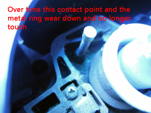

    The contact point that wears down

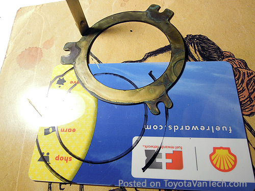

    At this point you should clean the ring if there is any build up or a rough line around the edge by lightly sanding it.
    To raise the ring high enough to touch the contact point I used a card the same thickness as a standard credit credit.
    Trace and cut out

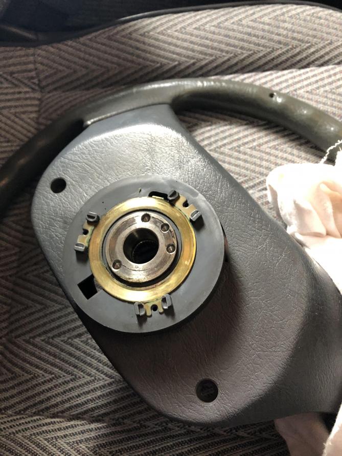

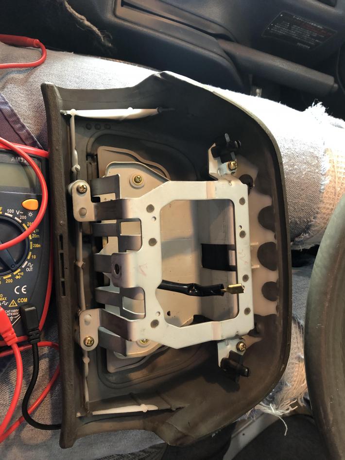

    well, glad this thread existed. having same intermittent issue, and then continuing to no horn.
    pulled my steering wheel off, LiteAce van,
    Was hoping cleaning the contacts with sandpaper would do the trick. I check the continuity only after the use of the sandpaper, was good.

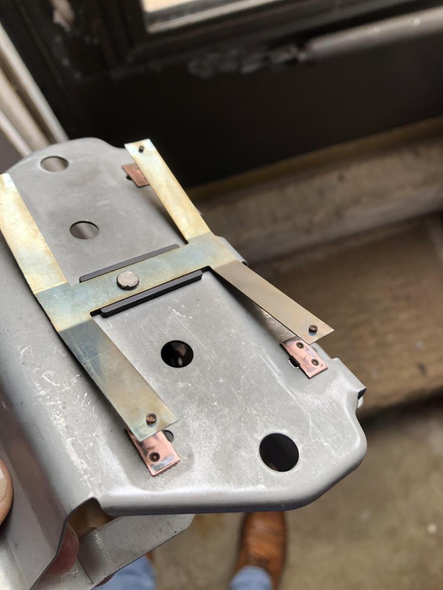

    Adding the thin plastic spacer was a no go for me, the plate is not screwed in, I was too concerned if I pried it off the plastic tabs that hold it in place would break and not hold it back in there. I could look for some screws to secure it but didn't.
    I fiddled with the punch looking piece that has the spring on it, I could not get it out so I just cleaned all the copper or brass pieces and reinstalled and the horn is working.... for now.
    If it does it again will try the .22 casing.
