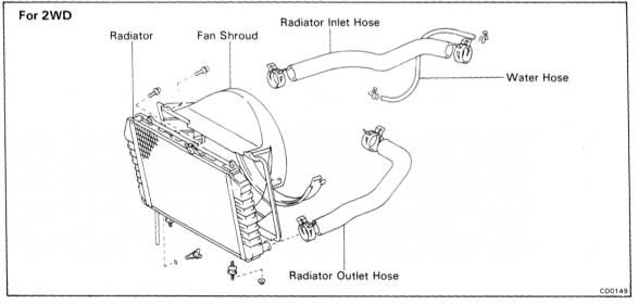

    Getting to know all the coolant hoses of your Vanwagon!
    See THIS Library Article for an illustrated tour of Toyota Vanwagon coolant hoses including part numbers!

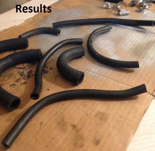

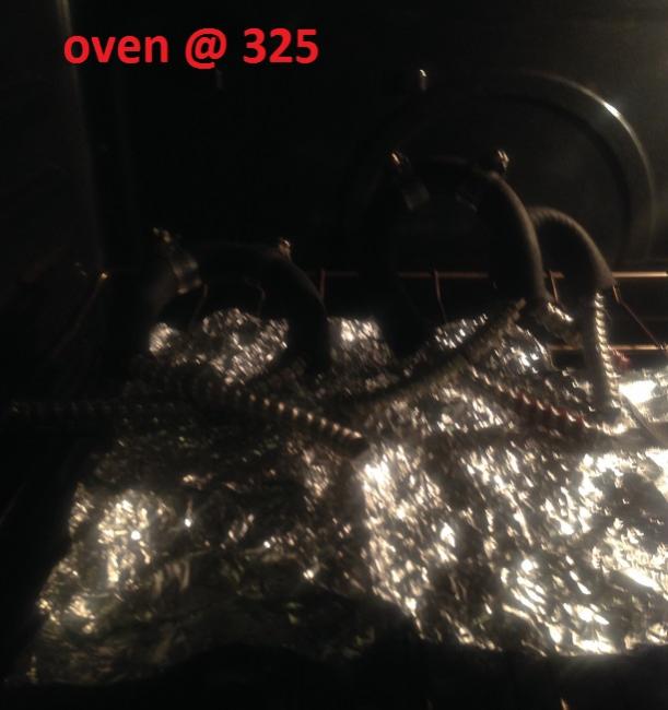

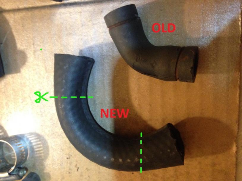

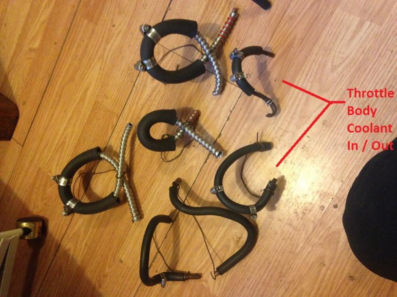

    DIY Hose Molding For Anyone Interested:
    In the process of engine reassembly I didn't feel like hunting down a bunch of discontinued hoses or paying 15 bucks or more for a simple bend in a hose, so I took the wingnut route and tried my hand at some DIY hose molding.
    Basically, I filled some bulk hose (in this case, 5/8th heater hose and some 5/16ths vacuum) with the largest flexible material I could (with some pb blaster on there to remove it later) and baked them at 325 degrees for 11 / 10 minutes respectively. The results were pretty satisfying. Not as perfect as factory made stuff, but I used them all in reassembly and they all fit pretty well.
    The tightest bend (forward side of air intake chamber to pipe) came out slightly pinched but still very open and certainly better than without the treatment. Most of these are for air, so I was more willing to take risks without fear of a catastrophic overheat like with coolant (although 2 of these are for the TB coolant (de-icer?) lines).

    The hoses all relaxed a little when I took the pipe out of them post-oven, but they very easily flexed back into the bend I "molded" without kinking

    Radiator Outlet Hose Replacement ADVICE
    New (proud) 1989 Toyota Van EFI LE, bought cheap with a leaky rad. I found a visible crack in the radiator outlet hose. This is this part I believe (lower hose)
    Name:  Screen Shot 2018-10-01 at 10.52.28 PM.jpg
    This only runs to the overflow tank I believe (am I correct?). I think I can replace it as long as I can find the part, could this be it? Has anyone used this site before?
    https://www.toyotapartsdeal.com/oem/...264-46010.html
    The front end is difficult to access, I think access from underneath would be better, too many wires going in from above.
    Thanks for the help
  21. #19
    Administrator llamavan's Avatar
    1985 5-sp cargo (Trustyvan) . . . . 1989 5-sp 4WD DLX (Skylervan)
    PNW
    1,817
    Re: Radiator Outlet Hose Replacement ADVICE
    Quote Originally Posted by jedzeppelin View Post
    No, it runs from the bottom left (driver's side) of the radiator to the thermostat housing on the front left side of the block.
    Coolant overflow tank has a single (skinny!) siphon line from it to the filler neck where the "radiator cap" fits, and then another short line for any overflow to dump out.
    To access the lower rad hose from above, lift off the coolant overflow tank (unplug the wire to the coolant level sensor FIRST) and ... there it is.
