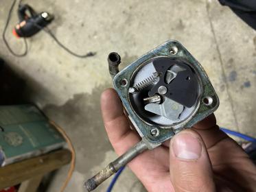

    So last night I pulled my intake and got the air valve out, and unfortunately it looks good, as illustrated in the repair manual??? Looks just like my other one, open just slightly at room temperature. Ohms are the same on both too, at 44.
    I’m wondering if anyone knows a little more specifics about how these work. Like what’s the 7mm adjustment screw do? Does the heat coil change with coolant temp and then move the gate valve accordingly? If so then what is the actual electrical connector for? Or does it run off the ecu temp switch (which I have also replaced)? Lastly has anyone experimented with rebuilding these using parts from other Toyota air valves? I looked around online and it seems like other models had air valves just with different shapes.
    I’m taking my fuel injectors to be cleaned and tested and I’m waiting on an intake gasket from rockauto, so I have a little while to figure out what I’m going to do. I would hate to put my new/old air valve in and have the same problem. Any input would be greatly appreciated, this forum has been a lifesaver.
