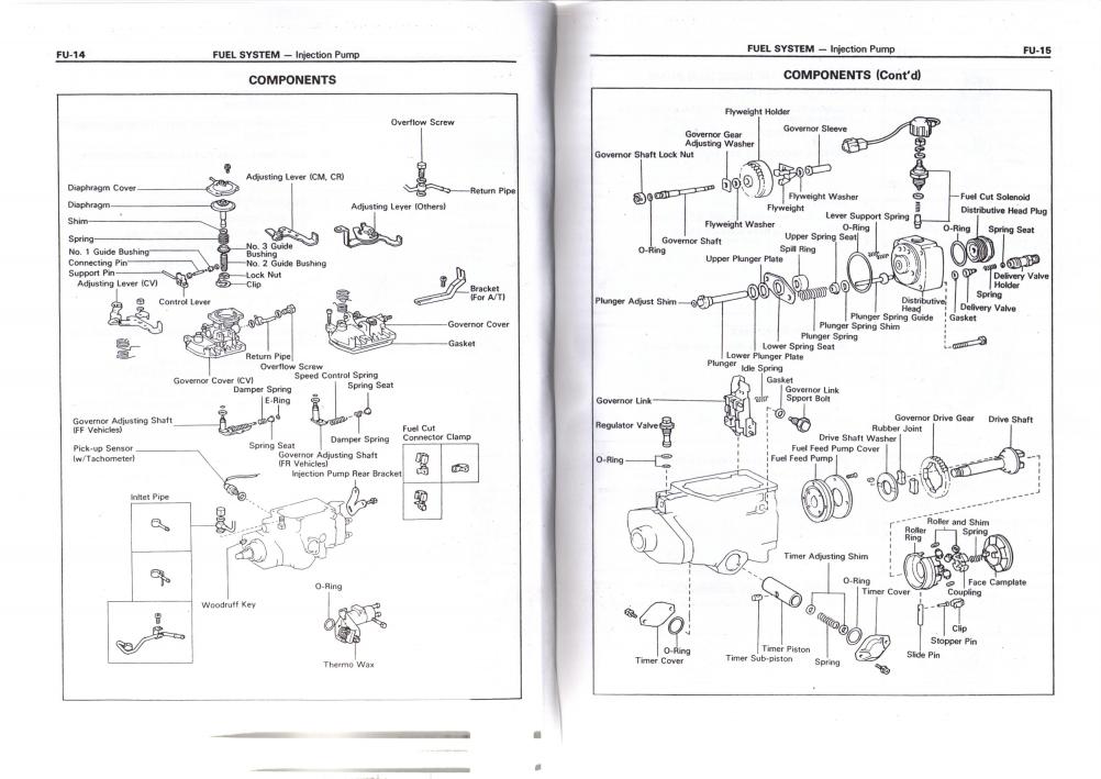

    Here are photos of the FSM for the 2ct procedure:
    Name:  028_2ct-Diesel engine0013.jpg
    Name:  028_2ct-Diesel engine0014.jpg
    Here is an exploded view showing the distributive head.
    Name:  002_Diesel Fuel System0008.jpg
    You basically take a bolt out, put indicator in, and then you are measuring the plunger travel from BTDC to TDC. Don't skip the cold start lever part.
