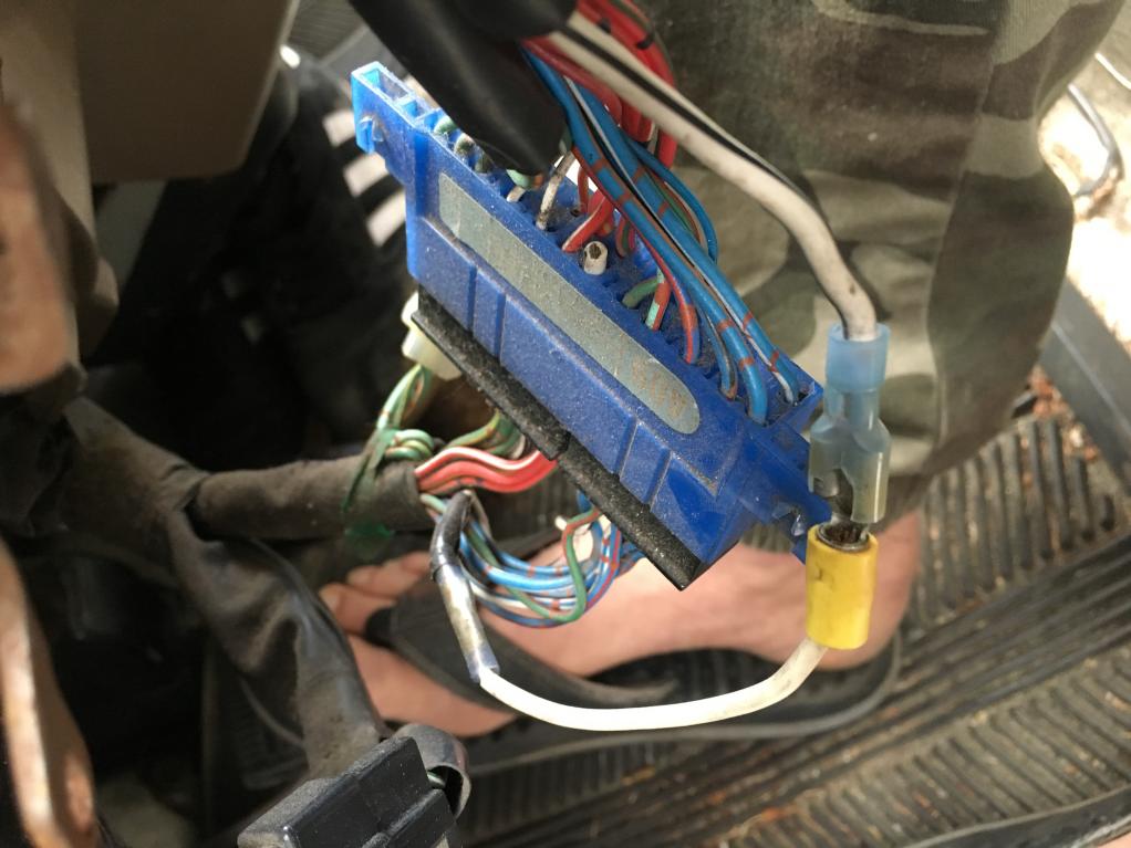

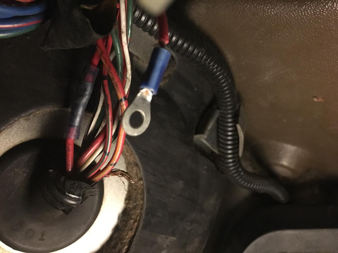

    Head light trouble shoot
    I had some work done at the mechanic a while back on my headlights. I got the van back with only my low beams working. Toggle the lever for brights and the lever 'clicks' but no change to highbeam and no blue high beam indicator light in the dash.
    yesterday I had a look at the wires under the dash going into the headlight harness. There's a range of colored wires and two solid red ones. Both solid red have been cut. One was rejoined (which powers the low beam). The other was not connected, so I reconnected it. Reconnecting the 2nd red turned on the hi-beam.
    Thats progress but still leaves me with low and hibeams on simultaneously. No good.
    anybody know where I can look to troubleshoot the toggle for hi/low beams? Steering wheel column?
    or any other advice is appreciated.
    my goal is to get some brighter LEds I bought working. Right now when I plug them in (in place of the low beam) they are 'stuck' on bright. They are the type that have hi/low on the same housing.
    In the pic you can see the circle connector I was using to test the 2nd cut red wire (hi beam)
    thsnks!

    Re: Head light trouble shoot
    This is under my steering wheel. White wire seems to have been moved. Anybody know of this wire is part of the headlight circuit?

  9. #29
    Van Enthusiast VanCo's Avatar
    1987 Toyota Van LE 4x4 5spd, on 30x9.50R15s, boosted to 16PSI
    Mar 2017
    Salt Lake City
    186
    Re: Headlight problem
    These vans have a positive supplied to the headlights, and the high/low beam switching is done using negative voltage.
    The 4x6 LED lights require a fixed ground, and the high/low switching is done using positive voltage.
    To make the LED lights work EXACTLY in a way the factory lights worked (low beam two outside lights, high beam all four fully lit) you need to use a couple of relays to swap the voltages from negative to positive.
    A lot of people are making these LED lights "work" in different ways, but unless you do some creative rewiring it's not proper, and not the factory configuration.
    I recommend getting regular incandescent lights to work properly first, and then go from there to get the LEDs working.

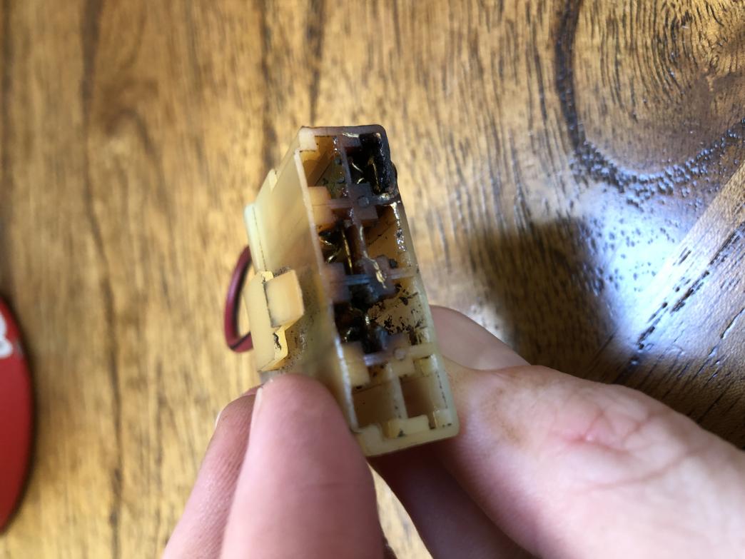

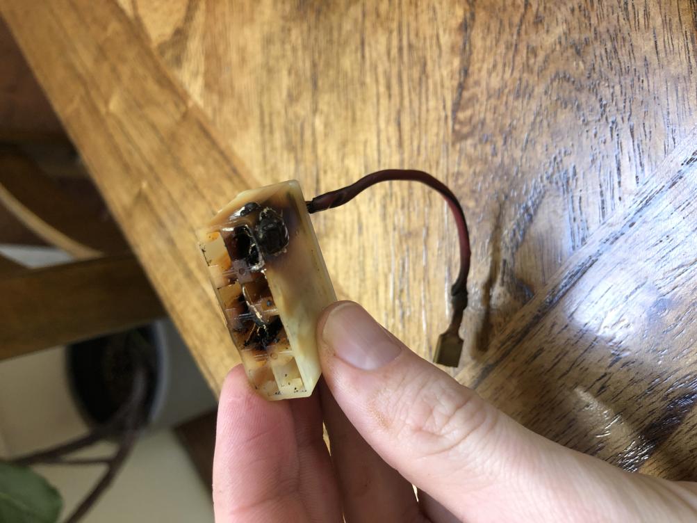

    Chiming into this thread with my current situation - headlights have been giving me grief lately and I've found the problem. This connector has gotten too hot and is basically fried.
    I've purchased these:
    https://www.ebay.com/itm/283127097732
    to replace the connector, I'll chime back in if it fits and share the results. I'm going over my grounds and will update once I get it sorted out.

    Re: Headlights out (all of them)
    Quote Originally Posted by cornell View Post
    Update here: I crimped existing wire into new connectors and used the ebay generic connector link and my headlights are back in business. I replaced the relays while I was at it and everything seems to be fine for now.

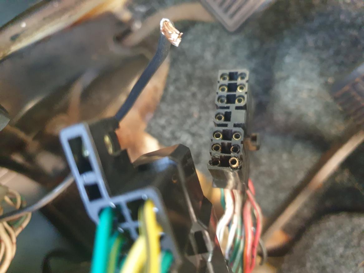

    G'day im having similar issues with my 1985 hiace van. i used to pull the highbeam stick towards me to use it but it eventually failed.
    I replaced the instrument cluster and wiring and noticed i have 3 burnt out connector pins. I have my hb indicator working properly again and some lights. however i do not have any high beams, only one working parkilight and healdlight on the right side and the left a veru very feint headlight.Name:  16690177911515231040397682745181.jpg
    I noticed my taillight relay waa getting warm so ive ordered a new one of those but im wondering what else it could be to fix it. Someone already did that bypass previously i found out.
    Any help would be greatly approciated!
