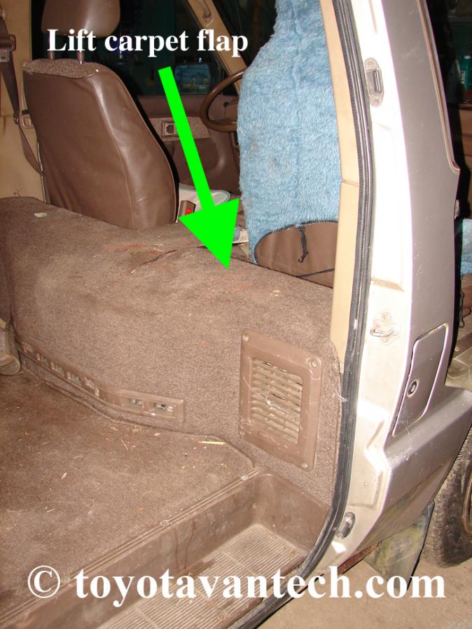

    Open the slider door. Yes, really!
    On 2nd generation (’86-’89) vans, slide the passenger seat forward first.
    On 1st generation (’84-’85) vans, the passenger seat doesn’t slide, so don’t try!
    The left cover (that should have a plastic-headed wing nut, but might not) is the access for your oil filter, power steering fluid, and (on automatic vans), the tranny fluid dipstick.
    Also notice that behind the driver’s seat on the floor is another carpet flap hiding the cover for the battery!
